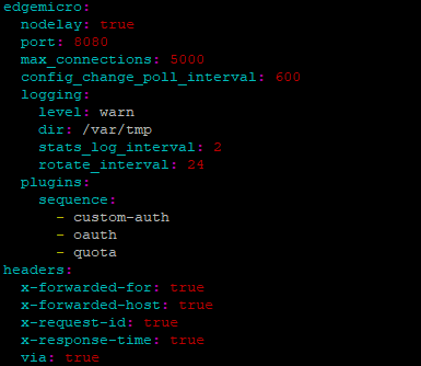

  1. What is the size/capacity of the machine?
  2. What tool was used to generate the requests?
  3. Can we see a copy of the org-env-config.yaml file?

1. I am using AWS Ec2 Instances of type t2.micro and t2.medium. I have increased the ulimit of the instances to 4k.
2. I am using "Locust" software to generate the load.
3.

Can I please see the OAuth stanza? I want to make sure the token is cached. That will improve the performance.
t2.micro is rather small (1 vCPU and 1 GB RAM).
Lastly, how many clients/consumers are you starting? What does the output netstat say? I would like to know the number of TIME_WAIT and LISTEN TCP connections.
