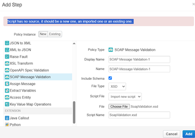

Error adding XSD script to SOAP Message Validation policy
When attaching SOAP Message Validation in API proxy, am getting error while adding .xsd file to soap message validation policy
1. When creating policy, if I select file type as "XSD" and Script file as "Create new script", am getting error message "Script has no source, it should be a new one, an imported one or an existing one."
2. When I pre-populate xsd script in resources and add my .xsd file to the resources, then when i come to add policy->select Soap message validation policy -> select existing .xsd script, the error says
"File extension does not match selected file type. Found: .xsd; Expected: .wsdl

Hi, thanks for reporting this. Can you attach a screenshot for each of  these two errors?
Hi , This is the screenshot of the following error
