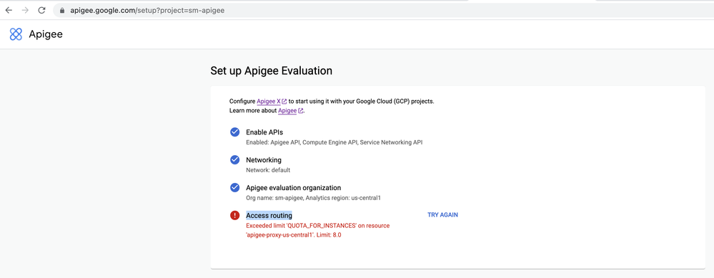

Exceeded limit 'QUOTA_FOR_INSTANCES' on resource 'apigee-proxy-us-central1'. Limit: 8.0
I am trying to create an apigee x eval env following https://cloud.google.com/apigee/docs/api-platform/get-started/eval-orgs?hl=en#external-access
However, I got struck on the last step of Access routing with the error: Exceeded limit 'QUOTA_FOR_INSTANCES' on resource 'apigee-proxy-us-central1'. Limit: 8.0
Screenshots below:image.pngimage.png
PS: I created a new GCP account so I don't have the option of extending quota and it won't be available anytime soon.
