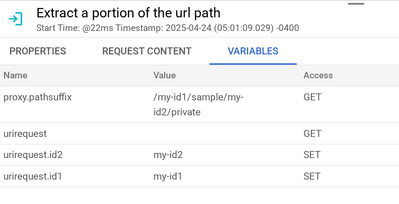

The proxy with basepath /api/v1 can use the Extract Variables policy to extract the two IDs from the URI. Example:
<ExtractVariables continueOnError="false" enabled="true" name="extract-ids">
<DisplayName>Extract a portion of the url path</DisplayName>
<Source>request</Source>
<URIPath>
<Pattern ignoreCase="true">/{id1}/*/{id2}/*</Pattern>
</URIPath>
<VariablePrefix>urirequest</VariablePrefix>
<IgnoreUnresolvedVariables>true</IgnoreUnresolvedVariables>
</ExtractVariables>
curl https://{your-domain}/api/v1/my-id1/sample/my-id2/private
see: https://cloud.google.com/apigee/docs/api-platform/reference/policies/extract-variables-policy#sample...
