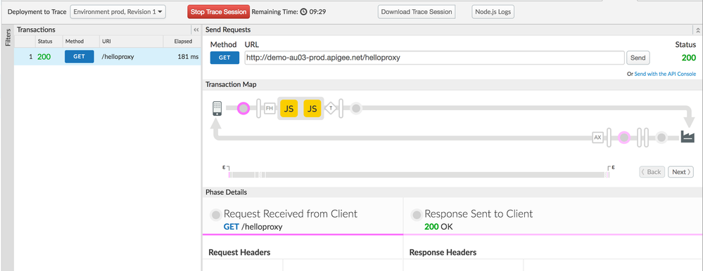

I gave it a try, It works when i tested same in "prod" environment "Pre Proxy Flow Hook", But same in "test" environment failed to execute. Looks like some kind of configuration issue.Let me confirm same by testing in other orgs.
"Prod" Environment - Pre-proxy Flow Hook , Works as expected :
"Prod" Environment - Pre-proxy Flow Hook , Pre-target Flow Hook, Post-target Flow Hook, Post-proxy Flow Hook Works as expected :
Doesn't work in test environment,
Clearly looks like env - config issue.
Let me explore more in a different org.
Update : It works as expected in other orgs.
Looks like it's an issue with demo-au03 org test environment only. I suggest to open a support ticket with Apigee support since it's particular org & environment specific.
Hope it helps.
Hope it helps.
