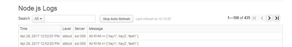

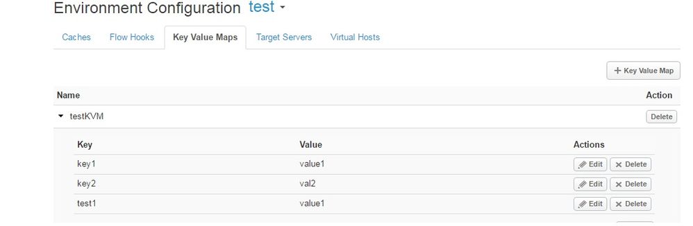

@Samuel Sayler : I can see the code snippet works fine. ie., i retrieved the KeyValueMap (named as TestKVM) from my environment(test). Please ensure the KVM Identifier created in correct environment(test / prod/ or customised one).
var express = require('express')
var apigee = require('apigee-access')
var app = express()
app.get('/', function (req, res){
var kvm = apigee.getKeyValueMap('testKVM', 'environment');
kvm.getKeys(function(err, keys_array) {
     console.log("All KVM => " , keys_array);
     res.send (keys_array);
//res.send(err);
}) app.listen(3000, function () { console.log('started up.') })
If this issue different then please provide bit more details. Hope it helps.
