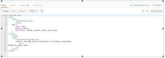

  • Our APIGEE APIs returns http 504 intermittently. We noticed that after a bounce in the message processor server it will be ok but, will be back again in a short while.
  • Our APIGEE Message Processor has default 57 seconds timeout as per apigee documentation.
  • When also noticed that most of our API calls just keeps on loading. If they even stop loading http 504 was already thrown in our calls. Also the first policy (regardless of what kind) will always have a large processing time for some reason.

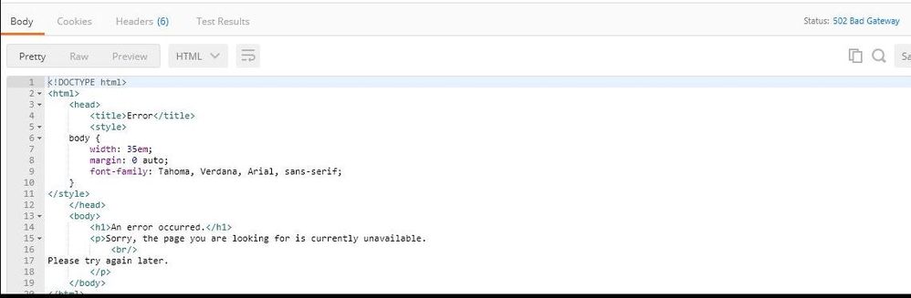

  • We also experience such situation where APIGEE blocks every request and returns http 502 bad gateway. Checking on the trace nothing shows up when we hit this scenario.

Hi All, Thank you for those who had share their thoughts on this. It seems like we found the issue. For some reason the Message Logging Policy on one of our proxy chained API Proxy is causing the issue as it continuously throws a "Broken Pipe Exception" when checking the MP Logs. What we did is to disable the message logging and everything has been ok since then.
