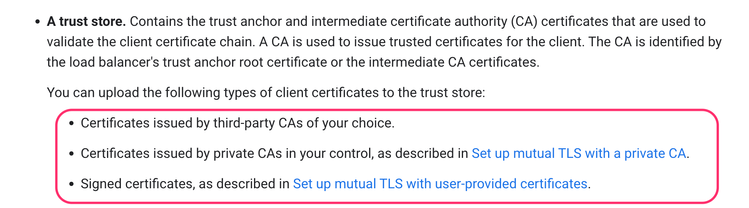

You do not need a private CA.  That article discussed a private CA, but there's no need for you to use a private CA.  You can use your own CA.  You should refer to the documentation on mTLS configuration  for the load balancer, which is here: https://cloud.google.com/load-balancing/docs/mtls
It says that you can use Certs provided by a third party CA of your choice, certs provided by a private CA, and self-signed certs.
