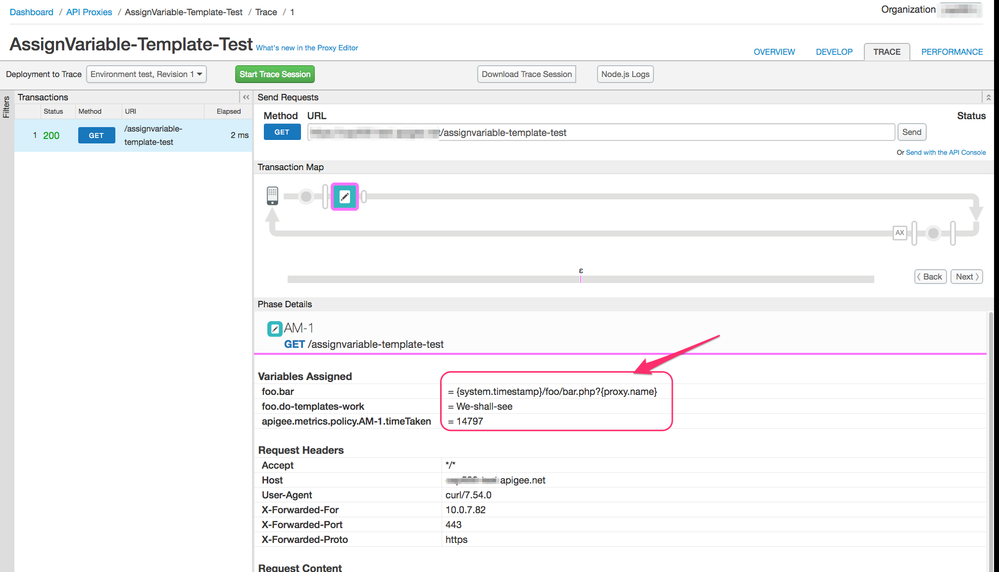

I just tested this with this policy:
<AssignMessage name="AM-1">
    <AssignVariable>
        <Name>foo.bar</Name>
      <!-- will not work>
        <Value>{system.timestamp}/foo/bar.php?{proxy.name}</Value>
    </AssignVariable>
    <AssignVariable>
        <Name>foo.do-templates-work</Name>
        <Value>We-shall-see</Value>
    </AssignVariable>
</AssignMessage>
And when I ran a request, I got this result:
...which shows me that the Value element inside AssignVariable does not interpret curly braces as variable references.
There is a ticket asking for this behavior, APIRT-1180. The capability is not yet available in the product.
