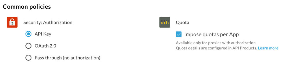

If you create a new API Proxy in Apigee X, the wizard has an option for including a default authentication and quota policy.. (You can always use a different authentication policy, but I'll use apikey for simplicity)
This will give you a proxy with 3 policies - Verify API Key, a policy to remove the apikey, and a quota policy preconfigured to use values set in the API Product.
