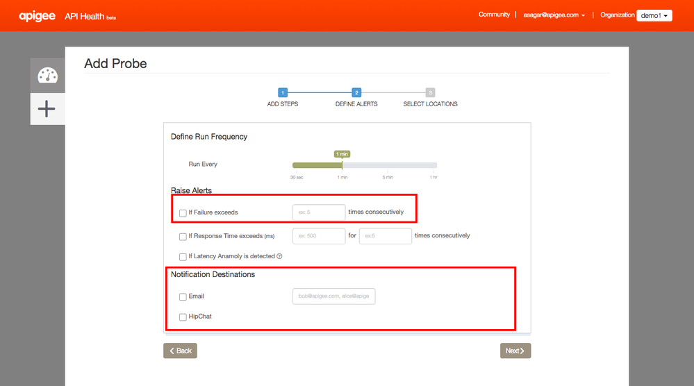

Yes, API Health supports this out of the box. You can add email notifications on failover in second step of Adding Probe.
For Example,
1. Add Probe
2. Configure Notifications,
  • Check - If Failure exceeds
  • Give count as 1 in the box if you want immediate alert on 1 instance of failover
  • Check Email Notifications, Provide Email Addresses separated by comma to get notified.

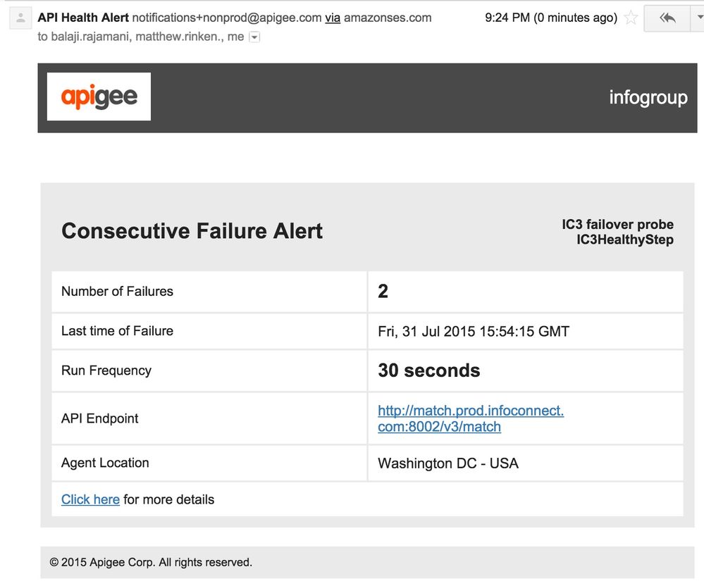

@Balaji.Rajamani Im able to get alerts for your probe. I configured myself to get the alerts. I was able see that in my inbox. Can you look at your spam folder ?
@vinothapigee Yes - we have firewall rules to allow requests from select addresses. Apparently, the api proxy and the health api probe don't share the same subnet/domain. At this time, I need to involve IT to get over this issue I'd think.
As for the question on the email notification, no, I don't see it in the junk/spam folder either. I need to see if our mailer filters it out automatically - now that I know the emails do happen.
Thanks for the support. Will keep the thread posted on any further updates.
Quick update:
1) If a publicly visible endpoint for the same service is put - the probe returns success - this corroborates the firewall issue we discussed before.
2) If I give another email address from a public vendor (not my enterprise email) - the email alerts work too - I therefore suspect either a reject by our enterprise mailing system, or a filtering. I'll probe further on this.
I definitely need to set up against our internal server (not the public end point). I'll work with our IT to see how to go about that and take it from there.
