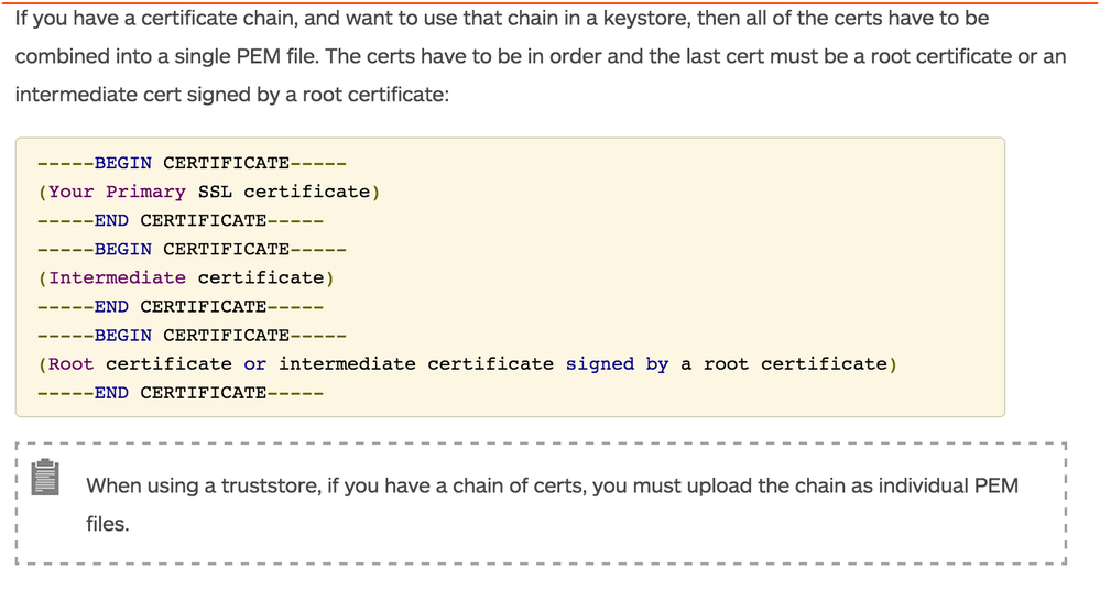

About the certificate chain thing, that line was indeed copied from the docs site. Also make sure you maintained the order of the certs like shown below. Here's the screenshot:

@AMAR DEVEGOWDA Since this is a long thread, I wanted to be clear about one thing:
The doc says "When using a truststore, if you have a chain of certs, you must upload the chain as individual PEM files."
But you are saying a truststore has to contain the certs in a single file. I thought that was only for a keystore?
Stephen
