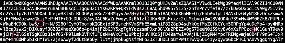

It is likely that what you are seeing is due to encoding issues.
Base64 encoding will produce some characters as '+'. For example, when I base64-encode a small image I have on my machine, the first set of characters is
I circled some of the + characters in the above.

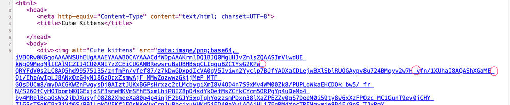

When I try to pass that directly as a query parameter, the receiver (in this case Apigee) interprets + as "space". Which is not what we want. If I then reference that queryparam value in the AssignMessage policy I get this result:
Again I circled where SOME of the + characters should be. They are not present. The decoding causes them to be realized as space (SPC) characters. This is not an Apigee "issue". This is the definition of how query params work (see IETF RFC 1630). For any HTTP server,  the + is interpreted as SPC.
And there is no SPC in the base64 alphabet. Within Apigee, "Decoding" + to SPC  will result in a string that is not valid base64, which means you get no image.
On the other hand if I URI-encode the base64-encoded image, translating each + into %2B , and pass the result of THAT as a query param, I see the image correctly.
So :
  • using assignmessage with the data&colon;image/png;base64, prefix, will work. The string you pass there must be valid base64.
  • passing a valid base64 string as a queryparam, without URI-encoding it, will necessarily cause the + characters to be interpreted as SPC. Inside the Apigee proxy, or any compliant server, that string will not be a valid base64 string.
  • if you base64-encode an image, then URI-encode THAT, and pass that as a queryparam, you can do the AssignMessage exactly as I described above.
