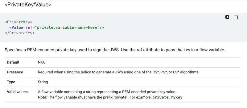

I think you are referring to public/private key cryptography, because you are saying "private and public", even though I have some confusion about your use of the word "certificate in there. And you said JWS, so that means Signing (not encrypting). Public/private key crypto , and signing, means you will use one of the algorithms in the RS*, PS*, or ES* sets.
For those algorithms, the documentation for the GenerateJWS policy states that you must supply the private key as a PEM-encoded key.

> Can I use JWKS for signing JSON payload as well using apigee policy ?
No, you must have a PEM-encoded private key, as per the documentation.
