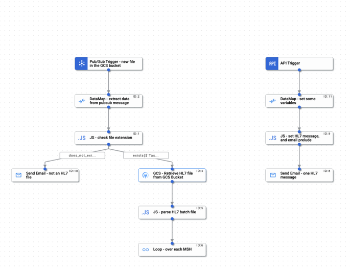

This is the canvas for an integration I built yesterday which.... picks up files from a Google Cloud Storage bucket, validates them, transforms them (splits into batches), then sends one email for each message in the batch.
