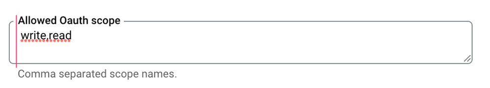

I am not certain, but I think I may have reproduced the issue you are seeing.  If I am correct, i  seems like a bug in the UI that is misleading you.
You've shown a snapshot the "Allowed Oauth scopes" field. Thanks, that that's helpful.  I tried your basic scenario in my own organization, and did not see the results you reported. In other words, it works just as I would expect: supposing I have a product with "READ,WRITE" scope, when I request a token with READ scope, I get a token with READ.  When I request a token with WRITE scope, I get a token with WRITE scope. And I can get a token with both scopes, too.  It all just works.
Then I looked a little more closely at the screensnap you provided. It looks like this;
Looking a little more closely, I wondered if there was a leading space in that text field, and if it was not being properly stripped. When I fill out the form on my UI with no leading space, it looks like this (I added the red line to help visualize alignment):
When I fill out the form and purposely add a leading space, I get this:
A slight difference. Sure enough, when I use the leading space and then save the product, and query it using the apigee API, I get this:

As you can see, I've saved a scope with a leading space. That shouldn't happen. That's a bug, in the UI and in the management API - both should reject the leading space.  (internal reference: b/265321035)
But when I try to use THIS product, then I cannot get a token with the "write" scope.  If I then modify the product to omit the leading space, I can generate a token with the "write" scope.
Let me know if this helps you.
