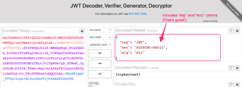

It's not possible for me to diagnose this with the information you've given. If I saw that message, the first thing I would check is: is there an algorithm in the header of the JWT? And the way to do that is to decode it. As you know the JWT is just a dot-concatenated sequence of base6-encoded things. The header is the first piece. So to decode a JWT, just split the string by dots and then base64-decode the first part. That will retrieve the JSON of the header. Or, you can use an online tool like this one to do that work for you.
Just paste in the JWT that you provided to the VerifyJWT policy, and check to see if there is a proper header. The header should have _at least_ an alg claim and an enc claim. This is an example of what looks right.
You'll notice that the Decoded Payload in the above image is shown as ?ciphertext? and that's because.... it's not possible to "Decode" the encrypted payload of an encrypted JWT. It's encrypted! No tool can "decode" it; the only way to recover the payload is to decrypt it, which is a cryptographic operation, which requires the cryptographic key. I haven't provided the key, and anyway that tool does not support the dir algorithm, so that decoder tool will not be able to show you the payload.
