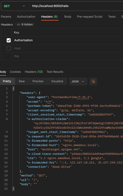

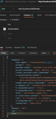

I have added custom plugin, below code sets host.
module.exports.init = function(config, logger, stats) {
  return {
onrequest: function(req, res, data, next) {
      req.headers['host'] = 'nginx.amadeus.local';
      next();
In the response, host is not modified, instead it is assigned to 'x-forwarded-host'. Host is still assigned to target endpoint host "mocktarget.apigee.net".
Is there any other workaround to fix this issue ?
