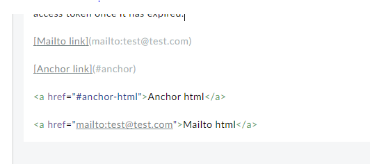

This is how I add it on the page:
[Mailto link](mailto:test@test.com)
[Anchor link](#anchor)
<a href="#anchor-html">Anchor html</a>
<a href="mailto:test@test.com">Mailto html</a>

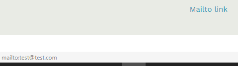

This is the result when I hover the link you sent (escaped) (looks incorrect since the domain is in the actual link):
This is the result when I hover the link I have (unescaped) (looks correct):
