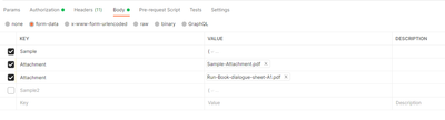

Modify form-data Request body - Add new Key-Value
We have an use case where were receive form-data payload with multiple key value pairs. I need extract value from one key, create an json object and assign it to new Key.
New payload should have the existing values along with the new one.
Example:
From the above screen shot. I need to extract value of Sample Key which is an json object and create a new Key Sample2 in the below json format.
"Trace-Id": "abc123ABC",
"Time": "{client.received.end.timestamp}",
"Payload": ["{Sample Value}"]
My Final req going to target system should look like below snapshot.

I think what you are hoping to do is.... Configure an Apigee API Proxy to accept a multi-part form request, which contains 3 parts. One part is a JSON payload and the other 2 parts are "attachments" which happen to be PDF files. You want the proxy to extract and then modify the JSON payload, then re-assemble the modified JSON payload into a multi-part form again, along with the original two attachments (unchanged).
IF that's the case, then I think you can do that manipulation using the Multipart form callout:
  • first, invoke the Java callout (MultipartFormParserV2) to parse the form and extract the parts,
  • then use a JavaScript callout to do the modification on your JSON payload
  • then invoke the Java callout (MultipartFormCreatorV2) to create a new multi-part message, using the modified JSON payload
The MultipartFormParserV2 will produce a couple byte arrays that contain the attachments. You can pass those as inputs to the MultipartFormCreatorV2 to create the form.
@dchiesa1 Thanks for the response.
Yes, I need to extract the first multi-part form key value(which is a JSON). Using the extracted value (JSON), I need to create 4th multi-part form(Eg Sample 2) in below format.

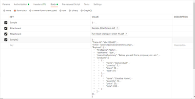

"Payload": ["{First multi-part Value(JSON)}"]
 My final req going to target system looks like below snap shot.

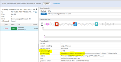

@dchiesa1
Am using below java callout to extract value from req and seeing below error
<JavaCallout continueOnError="false" enabled="true" name="Java-Callout-1">
    <Properties>
        <Property name="source">message</Property>
        <Property name="debug">true</Property>
    </Properties>
    <ClassName>com.google.apigee.callouts.MultipartFormParserV2</ClassName>
    <ResourceURL>java://apigee-multipart-form-20230117.jar</ResourceURL>
</JavaCallout>
message should have all the request content including headers and payload as per the documentation.

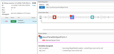

Error:
mpf_exception : java.lang.IllegalStateException: contentType must not be null
mpf_error  : contentType must not be null
 In request I have all the required values given in documentation.
content-length : 1003964
content-type : multipart/form-data; boundary=--------------------------185623916636805336267638

You are using it in the right way.  But... there is a bug in the 20230117 version of the callout, which did not handle parts which lacked a content-type header.
I've updated the callout, and I believe it should work for you now. Can you "git pull" and give it another try?
I got the latest code from the repo and now its working.
Thanks for fixing the bug @dchiesa1

Extracted JSON from Sample and created another JSON object in the required below format.
"Payload": ["{Sample JSON (First multi-part Value)}"]
Now am trying to create a new multi-part message called ENVELOPE with the modified JSON using MultipartFormCreatorV2.
