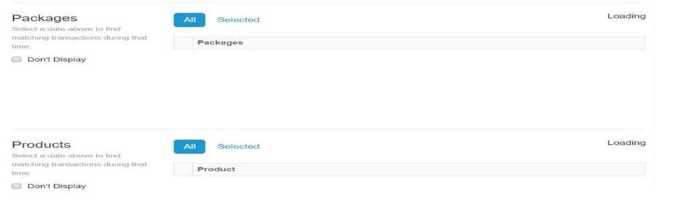

Please find below the issue we are facing while configuring the Monetization on Edge.
1. Issue we are facing while configuring the Monetization Report tab on Edge, Published packages & Product are not getting loaded.

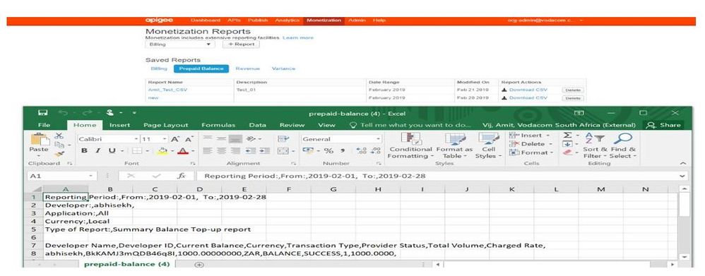

2. the transactions are not getting captured with RatePlan applied in the Reports generated under Saved Reports

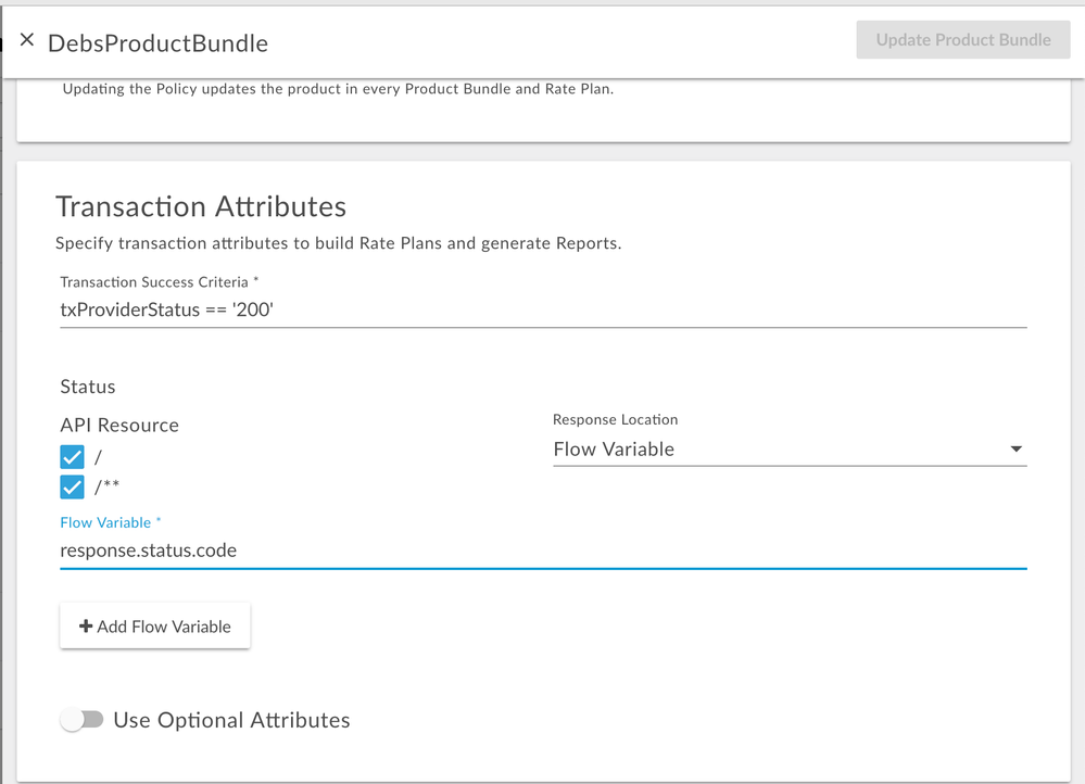

Check the following:
  • Package (Product bundle in the new UI) should have Transaction success criteria set so that the engine can determine which transactions to monetize. Here's an example where all transactions with a successful status code (200) are monetized:
  • Make a few calls to the monetized APIs
  • Use the transaction Status API to see if the transactions are being rated properly. https://docs.apigee.com/api-platform/monetization/transaction-status. If no transactions found, open a support ticket.
  • Then to see if the summarizing jobs work correctly, you should run the Summary report at least a half-hour later. Make sure to include the current date (default parameters leave today out)
  • If you're still not seeing a CHARGE line in the report, open a support ticket.
