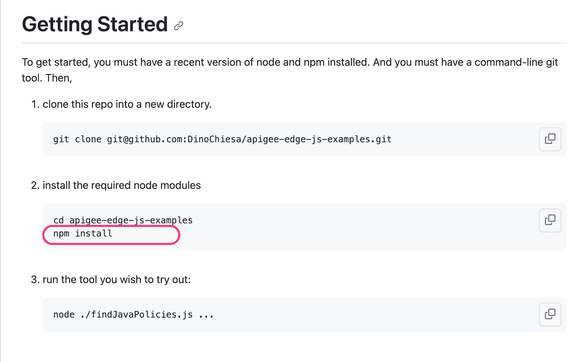

you need to run npm install.  This is described in the READMe.
