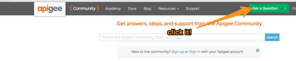

Hi OFS
Since this is a totally new question, can you please ask it with the Ask A Question button?
I will be pleased to help you if you do that.
