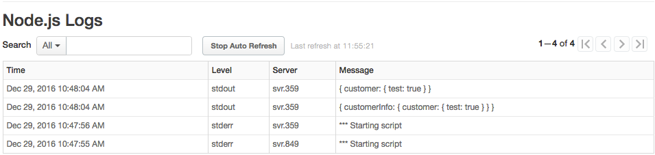

@Ashish sharma
The above is the screenshot for the node js logs.
Also, make use of path params for dynamically populating the customer values -
/customers/12345678/info'
