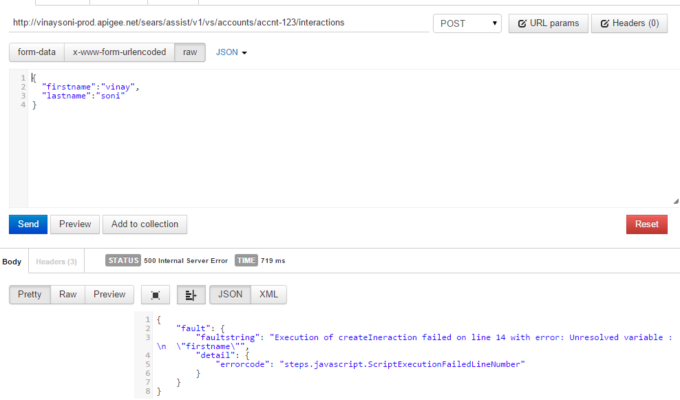

here's my snapshot of postman. i am getting error when i am trying to use "request.content" in my javascript. i tried it earlier.
and i don't have requirement to extract any values from json. i just need the whole json content as a string as mentioned above.

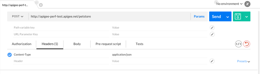

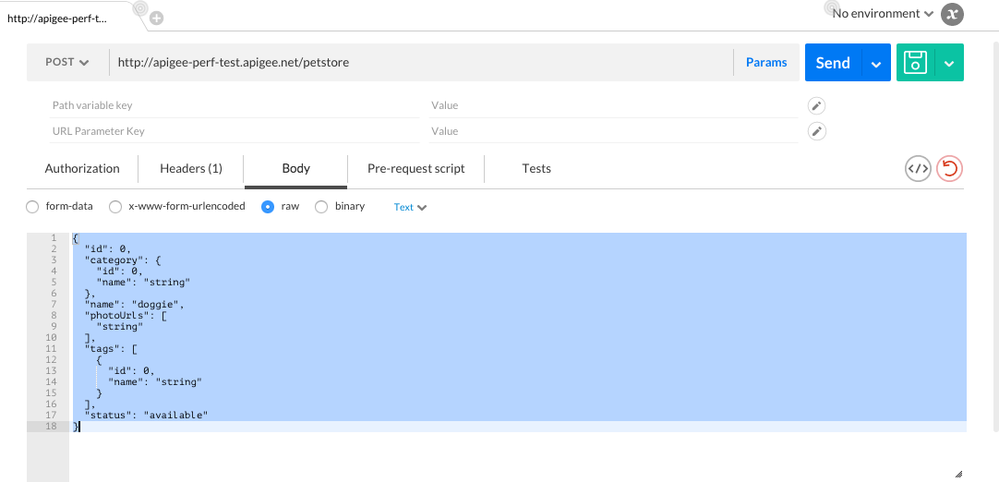

Please find screenshots below for your reference from my post man call. Make sure you set header with content-type application/json

@Vinay Soni , I don't see any error in trace. Did you use the proxy i have attached ? Can you post your javascript code & post man call too.. It should work out of the box.
