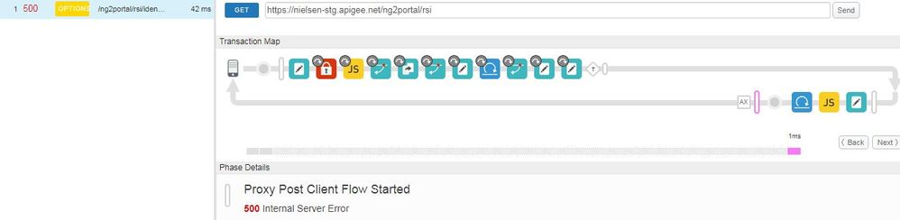

More information:
I am calling the api from a gui where I am getting a "no content" error. when i check in the developer tool of chrome, I am getting the error I described above.
And when I am checking the trace in edge, in response sent to client although it is giving 200 OK, but proxy post client flow is showing 500 Internal Server Error and the request is giving 500 response at the end.
Hope this is helpful to diagnose the problem.

I don't understand why you say there was a 200 OK. It seems clear from the trace screenshot that the response is a 500.
Aside from that, ... looking at the trace I can see...
  • in the request flow, there is an AssignMessage policy. It apparently succeeds.
  • in the response flow, there is a sequence of 3 policies - AssignMessage, JavaScript, ServiceCallout. Is it possible that the ServiceCallout is failing (aka receiving a non-200 code) and leading to the 500 error that your API Proxy is returning?
The screenshot is helpful, but... the static picture still does not give complete information. YOU CAN LOOK in the trace, explore the trace UI, and see what each of those policies is doing. You will probably discover the source of the problem. This is where the Trace UI excels.
