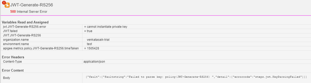

The jwtgenerate policy is able to generate token if I use the following private key formats.I'm storing the private key in encrypted KVM and referring that variable in the JWT policy

But if I encrypt these keys with passwords and use the encrypted private keys to generate, JWT trace tool shows the following "cannot instantiate private key" error

Update: 2019 December 20
Support for alternative encryption algorithms has been added to Apigee.
Regrettably, today the only key encryption algorithm supported is the default "TripleDES", aka des-ede3-cbc.
With openssl, you could generate such a key like this:
openssl genrsa -des3 -out private-encrypted-rsa-des3.pem 2048
If you use a different encryption algorithm, the policy will not successfully read the private key. For example, if you use this command to generate a private key:
openssl genrsa -aes256 -out private-encrypted-rsa-aes256.pem 2048
...then the key will not be parsed successfully by the policy. Similarly, if you use the genpkey command, like this:
openssl genpkey -algorithm RSA -out key.pem -aes-256-cbc -pkeyopt rsa_keygen_bits:4096
This is an arbitrary limitation in the policy and I've filed a ticket (b/79526748) to request that the limitation be lifted.
The fix is relatively simple, so I would hope we would be able to deliver that pretty quickly, possibly in the next cloud release.
