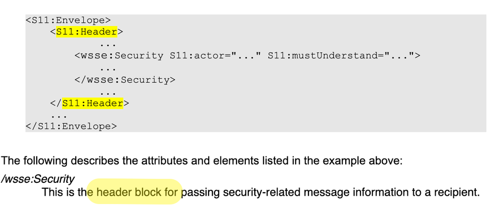

@pankajrai9026 wrote:
but as per standard signature element directly come in header part as well.
To which standard do you refer? I reviewed  the WS-Security specification in some detail. This is what it says in relation to signatures:
This document defines syntax and semantics of signatures within a <wsse:Security> element.  This document does not constrain any signature appearing outside of a <wsse:Security> element.
Ok, so that says that in the context of a Signature that is compliant with the WS-Security standard, the Signature element is ALWAYS a child of the wsse:Security element.  This is contrary to what you stated.
Also in that document,  I could not find a specific explicit statement saying that the wsse:Security header must always be a child of the soap:Header element. But, I did find repeated informal statements referring to the wsse:Security header block .
Also, every example shows the wsse:Security element as a child of the soap:Header.
All of this implies that the wsse:Security element is always a child of soap:Header.
Now, if you have a document that has soap:Envelope/soap:Header/Signature , that is perfectly fine.  XML is extensible, any application can organize the elements in the way it sees fit.  But such a signature is not compliant with the WS-Security standard.  The Java callout we are discussing here is used for Signatures that comply with the WS-Security standard.
If you have a Signature that complies with XMLDSIG on a document, this WS-Security Java callout is probably not the right thing to use. There is a separate callout for Apigee that can generate and validate signatures that conform to XMLDSIG.  Look here.  But this latter callout has some restrictions - it works by generating or validating signatures that apply to the entire document.  And the Signature element is always a child of root.  If you have Envelope/Header/Signature, then you may need to create your own callout that works with that non-standard scheme.
If I am overlooking a standard, please inform me.
