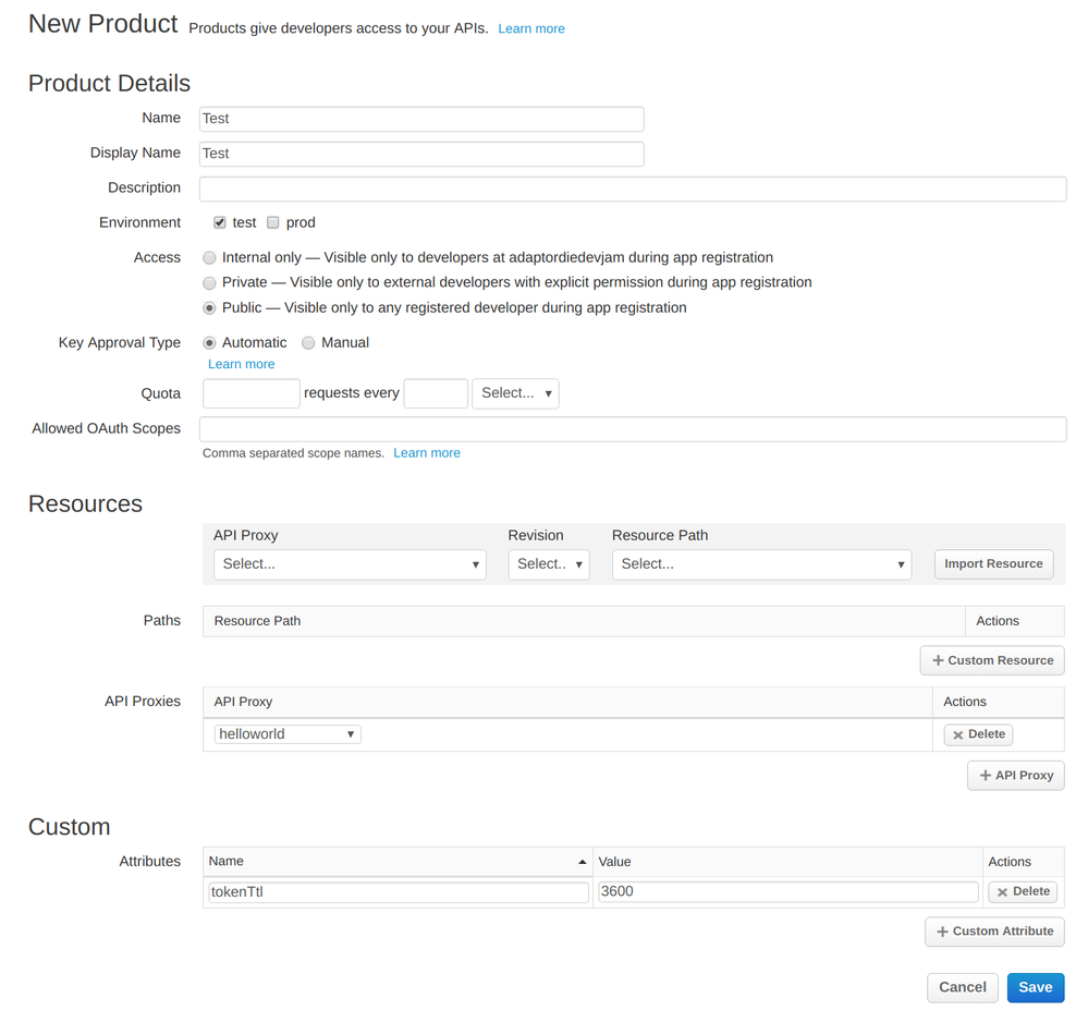

For example, in the screenshot below, I have a Product defined with a custom attribute (see bottom of the screenshot)
You need to include your Oauth proxy to this product as well. Once that is done, when you have a valid client_id (from the dev app that uses this product) and after running the VerifyApiKey on your Oauth token flow, you should be able to get the custom attributes as flow variables.
In this case., the above custom attribute will be verifyapikey.{policy_name}.apiproduct.tokenTtl. With this flow variable, you can set that in the Oauth policy that creates the token with the ExpiresIn attribute.
