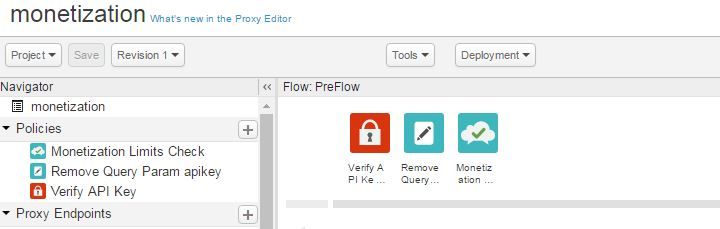

- Setup an API proxy with monetization enabled. It looks like

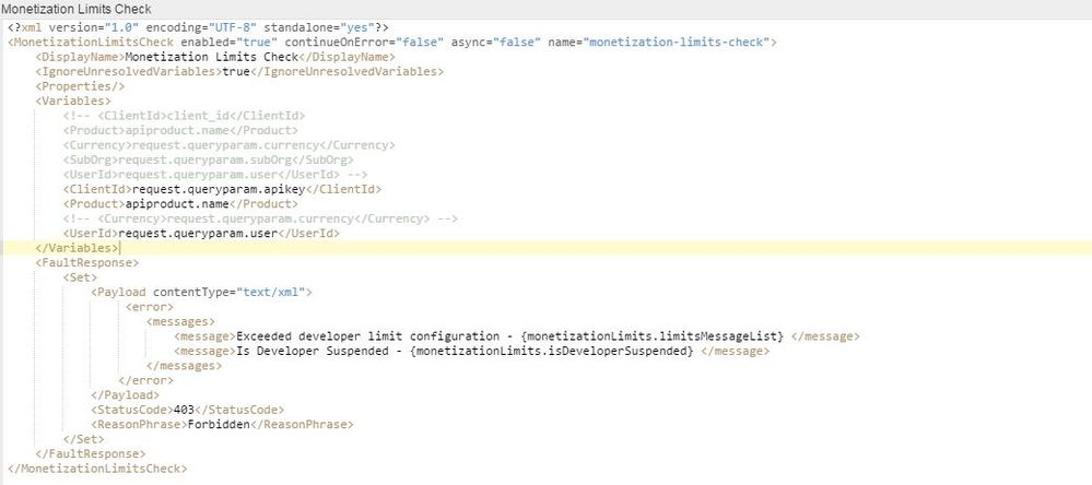

- The monetization policy is setup as:

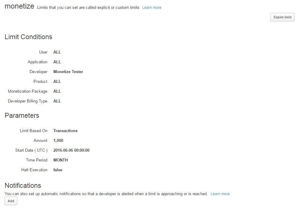

- Then we added Limits:
Now After this if I do a quick test to do more than 1000 transactions for the developer then it should show quota voilation. But right now I am stuck because it doesnt seem to work for a single transaction. Its always showing:
<error>
<messages>
<message>Exceeded developer limit configuration -</message>
<message>Is Developer Suspended - false</message>
</messages>
</error>
Is there any additional setup we have to do to do a quick test on monetization policy??

look like you hit the org limits
https://enterprise.apigee.com/platform/demo9/limits/e9a5313e-70ef-4c63-b5e6-28d27e9d5cf2
has 100 calls
and
https://enterprise.apigee.com/platform/demo9/limits/0fe771ae-4d99-4bfd-8288-ca055fab367b
Looks like somebody added them.
Going to expire those two limits and then we will try again
Also i added balance to your developer to avoid implicit limit
