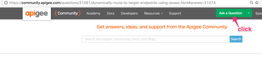

Hi
for new questions, ask a new question. Do not post new questions as comments on comments on answers to old questions.
Sure i will.
