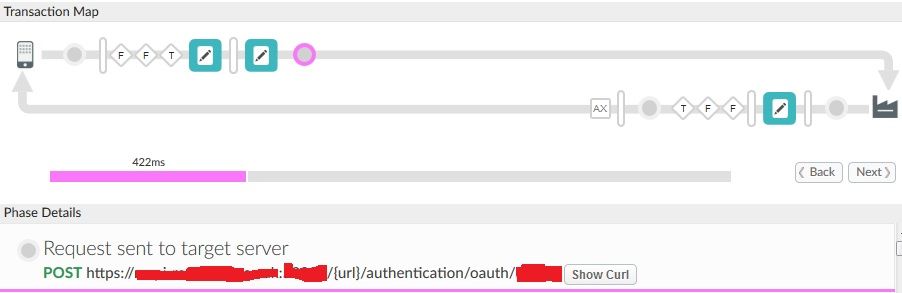

When I execute the proxy, the call is successful but when I have a look at the 'Request sent to target server' in trace, I can see that the variable is still present with curly braces along with the replaced value.
Does anyone have any idea as to why the trace still shows the variable within curly braces ({url})along with the replaced value of the variable?

Yes 🙂 It works fine, but the trace displays the variable name within curly braces!
Please find screen shot attached for you reference.

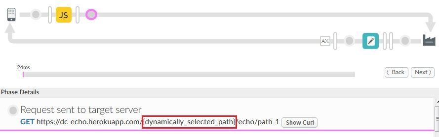

I tried and I am able to reproduce this issue, its a trace display issue.
I raised EDGEUI-1093 to address the same.
Thanks @Maruti Chand
Hi @Maruti Chand, @Dino,
We faced this issue in the apigee on prem version 4.17.05. Also there is a difference in our case. The trace shows URL like -
https://sample.com:4567/{url}/<dynamic_value_of_the_variable_that_should_be_set>
Although the URL that edge hits is -
https://sample.com:4567/<dynamic_value_of_the_variable_that_should_be_set>
I hope above ticket will fix this issue in that version.
