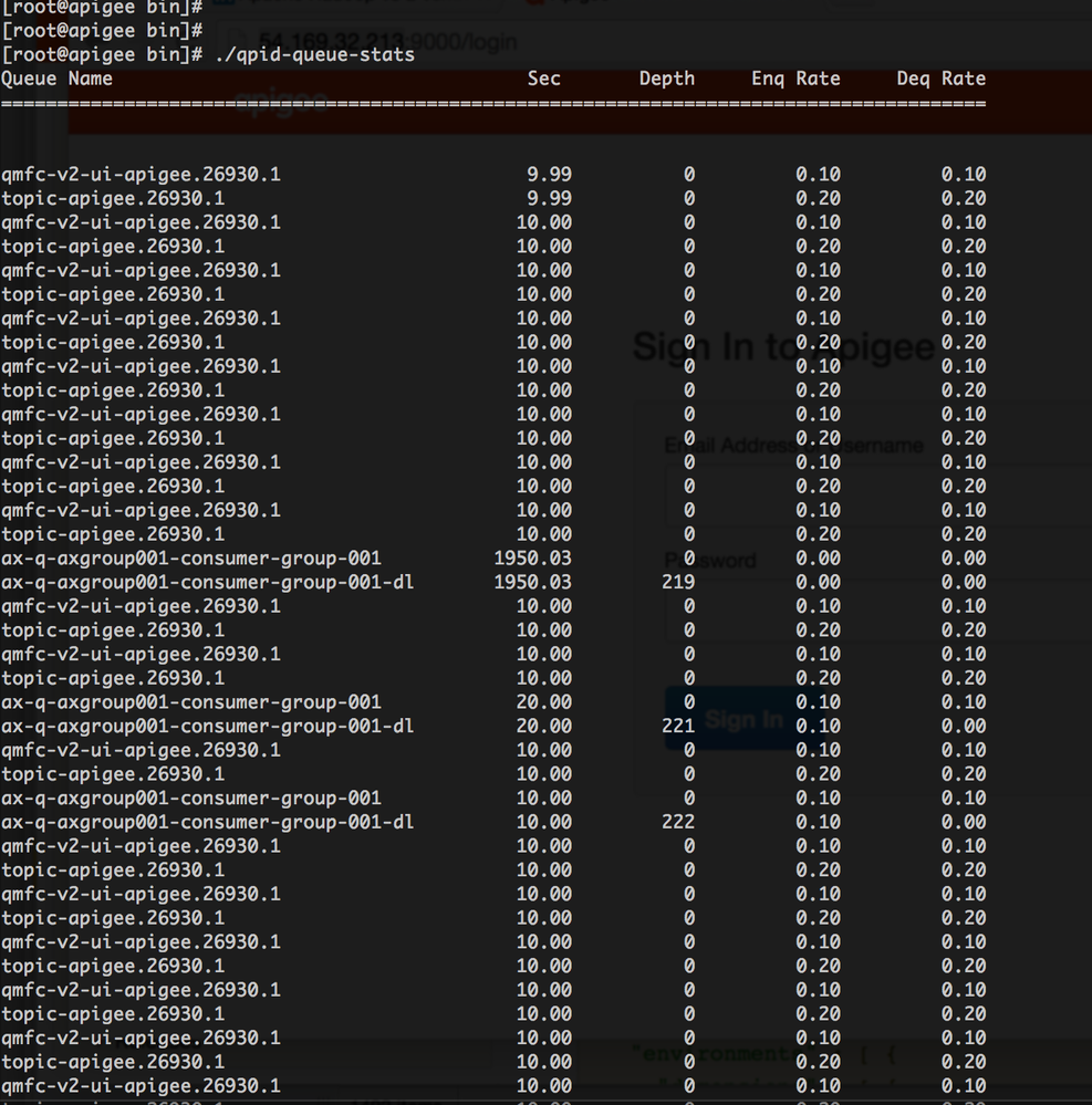

The analytics messages are stuck in the queues. The postgress table is empty
Checked the qpid queue status823-screenshot.pngscreenshot.png(463.7 kB)

HI @santanu4g,
have you run this script?
<APIGEE_HOME>/apigee4/share/installer/apigee-postgres-register.sh
Thanks,
HI @santanu4g,
Thanks,
Hi @Mukundha Madhavan thanks.
I did not run this script earlier. Thought the installation script should have taken care?
In any case, did run this script now. And then also restarted the apigee postgress-server process. Still no luck. Anything missing?
[root@apigee ~]# cd /opt/apigee4/share/installer
[root@apigee installer]#
[root@apigee installer]# ./apigee-postgres-register.sh
Enter global Apigee Edge admin password:
Validating Apigee Edge admin authentication...
[SUCCESS]
--> curl -X GET http://172.17.1.101:8080/v1/analytics/groups/ax/axgroup001/ [...]
 curl -X POST
http://172.17.1.101:8080/v1/analytics/groups/ax/axgroup001/consumer-groups/consumer-group-001/datast...
  "name" : "axgroup001",
  "properties" : {
    "consumer-type" : "ax"
  "scopes" : [ "tradexchange~prod", "tradexchange~uat", "nti~prod" ],
  "uuids" : {
    "aries-datastore" : [ ],
    "postgres-server" : [ "af5cc7ad-daa2-4bb2-b1ec-f5940dc25f7a" ],
    "dw-server" : [ ],
    "qpid-server" : [ "71071616-f81a-4200-a92a-dba549392498" ]
  "consumer-groups" : [ {
    "name" : "consumer-group-001",
    "consumers" : [ "71071616-f81a-4200-a92a-dba549392498" ],
    "datastores" : [ "af5cc7ad-daa2-4bb2-b1ec-f5940dc25f7a" ],
    "properties" : {
  "data-processors" : {
==> 200
UUID(s) af5cc7ad-daa2-4bb2-b1ec-f5940dc25f7a successfully registered to consumer group consumer-group-001
the apigee-setup does not run this script, - the output looks good Santanu,
strange - am not aware of any other issues -
there is no need for restarts - but anyways that wont affect anything
The consumer group is created, messages still stuck at qpid?
Not sure what else to check, maybe can you create support ticket?
My bad. Your trick already did it. Just that it took a while to show up. I was impatient. Thanks !!
