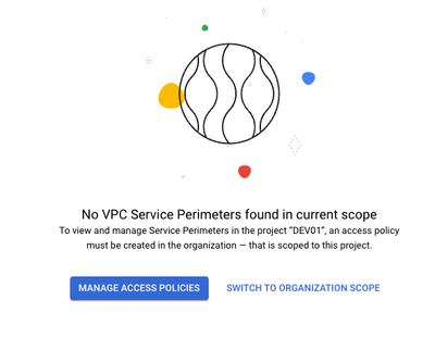

As for VPC-SC, I think this means it is not enabled?
