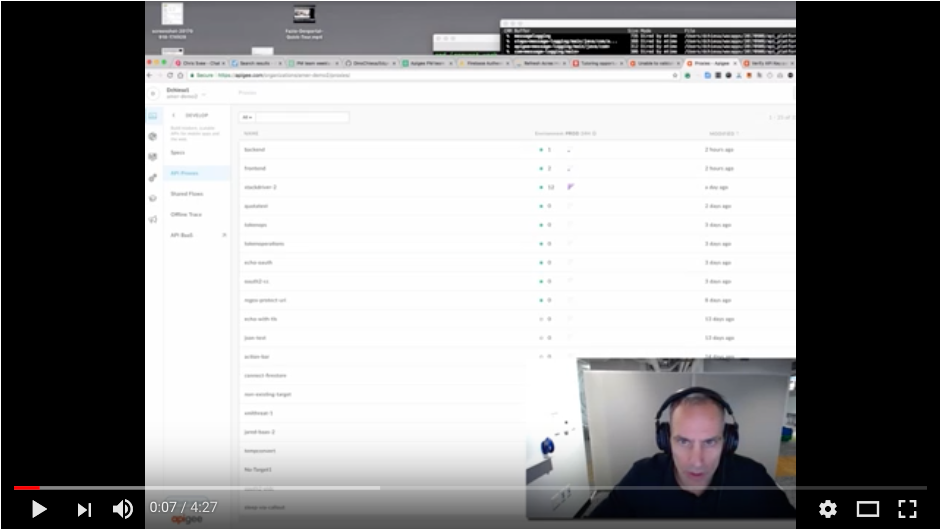

Here's a quick video demonstration.
Yes Dino.. you are absolutely right. I am totally confused with BaaS and Edge. Now I got some clarity on usage and it is working fine now. Your video is really helpful
