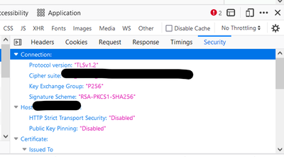

I found this issue in the under network section with Disabled value.
is that mean that I need to add certificate of something?
Getting CORS right can be tricky.
Something in the CORS response from your endpoint is convincing the user-agent (Chrome) to not allow the call.
The. problem can be in the preflight response, or it can be in ANY OTHER RESPONSE. The CORS headers must be present in all responses. The user-agent will interpret the response headers from every request.
The problem can be a missing CORS response header, or a header that is present but does not have the right value. As you know there are CORS headers for the method, the inbound and outbound headers, the origin.  And all of this stuff can be cached according to the access-control-max-age header. It's tricky to get it all right.
