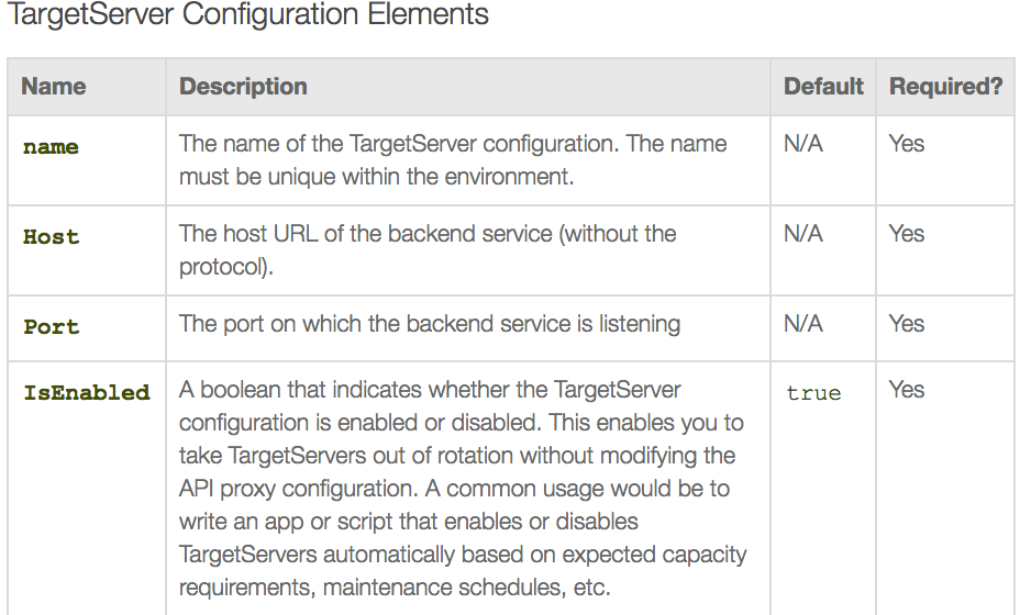

Hello @aabeling
I just checked http://docs.apigee.com/api-services/content/load-balancing-across-backend-servers and it displays that the default value for isEnabled is true.
I also checked the link that you provided and I did not see the default value listed on that page. Maybe you pasted in the incorrect link? If you provide the link to the page that has the default value of isEnabled:false, then we will make the correction. Thanks for the feedback.
Hi @swilliams,
If you check the management API documentation for updating a target server, in the request body payload descriptions it is mentioned that the default value for isEnabled is false. If it is wrongly documented then please correct. Ideally if you are adding a new target server then it should be enabled by default.
Thanks!
Thanks, @Mohammed Zuber
I submitted a bug against the docs so we should update it soon.
