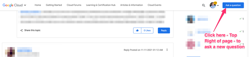

Sure, Apigee can do that. But your question is an entirely new one.  To get more details, I suggest that you Ask a New Question.
