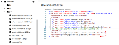

Thank you for the info detailing the update done from the main branch. However, the current error I'm facing with both the main branch and the suggested branch https://github.com/DinoChiesa/Apigee-Java-WsSec-Signature-2/tree/remove-str-transform is that the error message received in the debug session logs +  response suggests that the Class element is not detected. I'm curious on what could be affecting the situation as prior to 1-14-0-apigee-4 the JARs are working.
For reference of my proxy, here's what it has:
I have decompiled the JAR and confirmed that it contains the "Validate.Class" file being used for this scenario. Curious on what's preventing on proxy level to access the validate class.
Error in debug session logs:
Are you using Apigee Edge (managed) or Apigee X?  If so, You need to raise a ticket with Apigee Support.
There may be some log messages that they can show to you, to help diagnose the problem.
If you are using OPDK or hybrid, then, check your MP logs for more diagnostic information.
The "Failed to instantiate" problem can occur if the class in question is not available or loadable or any dependency of that class is not available or loadable.  Therefore, just because you have Validate.class in the jar, does not mean it will succeed.
If you are interested in pursuing this on your own, you can try some things.  As I have advised others in similar threads, make sure to include the dependencies for the Callout in the API Proxy. In my build environment, those dependencies include:
xmlsec-3.0.5.jar
commons-codec-1.17.1.jar
jakarta.xml.bind-api-4.0.2.jar
jakarta.activation-api-2.1.3.jar
woodstox-core-6.5.1.jar
bcpkix-jdk15on-1.70.jar
bcutil-jdk15on-1.70.jar
bcprov-jdk15on-1.70.jar
stax2-api-4.2.1.jar
slf4j-api-1.7.14.jar
I would start by providing all the bc*.jar files as environment-scoped resources, or ... as API proxy scoped resources.
A callout class may yet fail to load if the class static constructor throws or fails a permissions check. If this is the problem you need to change your code.
Yes, I'm using APIGEE X.
Thank you for the support and advise @dchiesa1 . Let me try the suggestion above and retest again.
