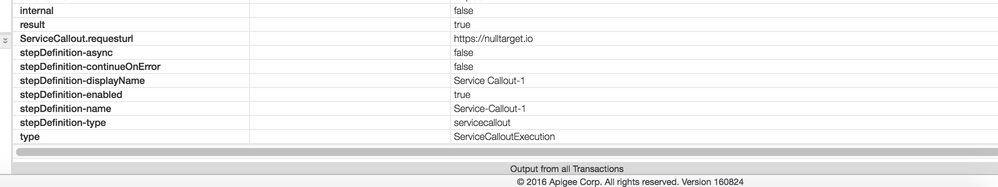

You could use a JavaScript policy that that prints the flow variables in the trace window. The example below would just print the error status code, which is the same status code that is returned in the default error response from Apigee. All of these error variables should also be available from the trace window.
print(context.getVariable('error.status.code'));
You can view the JavaScript print statements by clicking the "Output from all Transactions" button at the bottom of the screen.

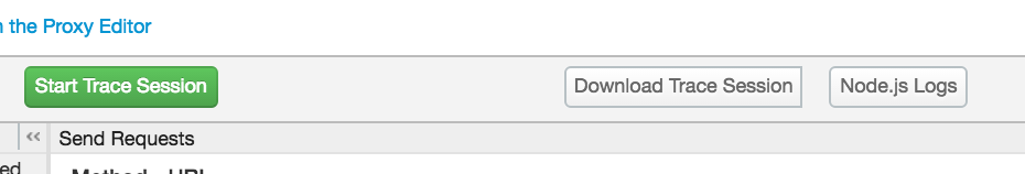

Additionally, you have the ability to export the trace sessions as XML. Click the "Download Trace Session". This is what I was requesting that you send to me so that I can review the results of the service callout and how it is configured.
