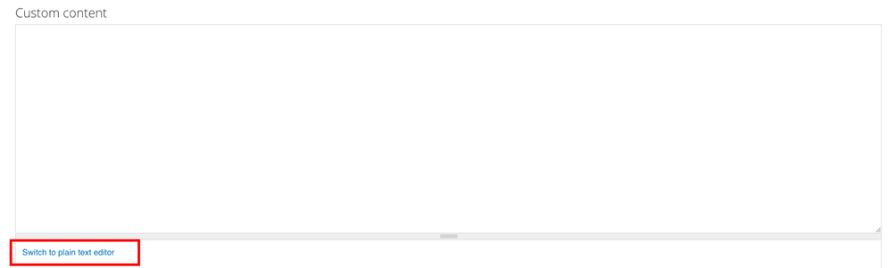

Dear @Emilio Fallau ,
Seems like it's editor rendering issue, Click on Switch to plain text editor to view the HTML, you will see the html code. Remove the links from html & save the block.
Thanks for your fast answer @Anil Sagar, when i changed to plain text, the html is it
<div> <div> <div> <ul> <li> </li> <li> </li> <li> </li> </ul>
<ul> <li><a href="privacy-policy" rel="nofollow">Privacy Policy</a></li> <li> </li> <li><a href="terms-use" rel="nofollow">Terms & Use</a></li> <li> </li> <li><a href="contact-us" rel="nofollow">Contact</a></li> </ul> </div> --></div> </div>
If you see, the icons not appear for modify his urls.
only appears in the web view.
