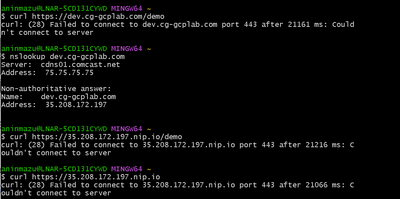

Hi Dinesh,
We fixed the issue of runtime. Thanks for the information you shared.
Now our Apigee-proxy is deployed in environment still we are getting same connection error as we it encountered before successful deployment,
while testing with  hostname and curl we are getting this error,
https://35.208.172.197/demo
curl https://dev.cg-gcplab.com/demo
curl https://35.208.172.197.nip.io/demo
any suggestion on this please?
Thank you.
Anindita
Is your hybrid runtime ingress exposed to your client and can accept traffic on https port?
Is environment group containing environment you have your demo proxy deployed to properly configured with hostnames you use when making a request?
In some cases curl with -resolve parameter may come in handy, but it looks like network issue judging by the screenshot you have provided.
From the error it looks like connection timeout, Is the ingress firewall open?
