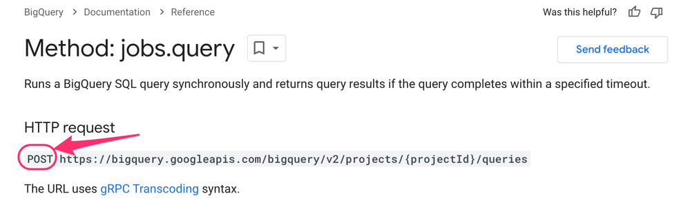

I ran the same request payload and target endpoint URL on https://cloud.google.com/bigquery/docs/reference/rest/v2/jobs/query and it returns the resultset successfully.
So what does this "404 Request couldn't be served" mean? I couldn't find any info from the google site. Could it be a permission issue?

Thanks, @dchiesa1 . I spotted that too and changed it to POST but still got the same 404 response. I also tried putting the access_token generated with a personal account with bigquery access to the datasource like this:

4. Deploy the proxy as apigee-sa@custom-altar-408201.iam.gserviceaccount.com
and it works with 200 OK!
Refer to this page https://cloud.google.com/bigquery/docs/error-messages for BQ error, 404 NOT FOUND error is:
