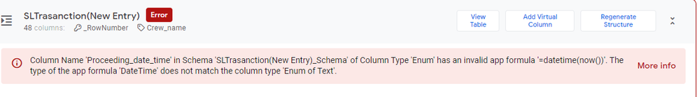

Like this?
This would result to an Error after saving. (shown in the image below).
Also, the button gives the remarks as the image below shows.
Because โ€œProceedingโ€ is not a DateTime value. Youโ€™d have to remove that option.
Iโ€™m not sure what you meant to โ€œremove that optionโ€. I tried to have a formula of datetime(now()) instead of โ€œProceedingโ€. But the result was Error in my appโ€ฆ
The ENUM datatype does not allow date time values as of this moment.
But Iโ€™m hoping that there is a work around on this.
This means that you still have the base type set as Text, not DateTime.
NOW() already returns a DateTime value, there is no reason to wrap it inside of DATETIME()
Yes it does. Though I have no idea why youโ€™re wanting to do this, and especially not if youโ€™re going to use an App Formula for the column, as that disables edit ability for the column, which is kind of the main reason for using Enum columns (easy user input).
Thank you for this Marc. It works fine.
