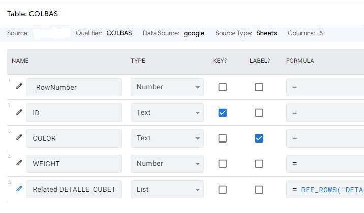

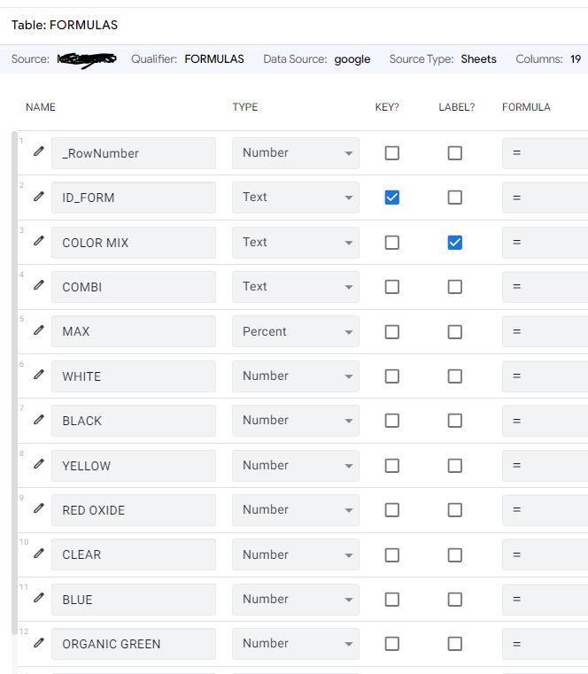

BASIC COLORS CATALOG IN SPREADSHEETBASIC COLORS CATALOG IN SPREADSHEETTABLE COLBAS (COLORS-BASIC)TABLE COLBAS (COLORS-BASIC)FORMULAS SPREADSHEET - notice that out of 10+ colors, only 3-4 are used in any given formulaFORMULAS SPREADSHEET - notice that out of 10+ colors, only 3-4 are used in any given formulaScreenshot of Formulas tableScreenshot of Formulas tablehere is the form with the erferenced listhere is the form with the erferenced listthis is the dropdown I want to reduce to only the needed optionsthis is the dropdown I want to reduce to only the needed options
I hope this gives you a better idea. I did some editing to the real data for the purpose of "privacy policies" and because my app is in a mix of Spanish end English, so I did some translating

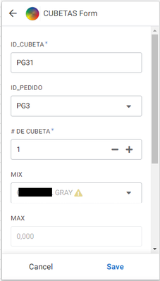

Thank you. Could you mention, on which table the following form is based on? And how the column MIX is populated there? Does it reference the Formulas table?
Let me see if this clarifies the questions
and this is how the form "Details" should work in 4 progressive movements:
A series of movements in the last table

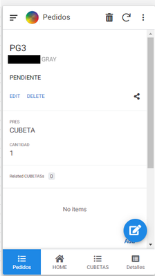

parent table ordersparent table orderschild table bucketschild table bucketsgrandchild table detailsgrandchild table details
the data on the desired (goal) color/mix is running through all tables

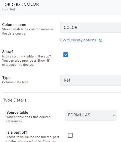

1. Please add a column called say [Combination] in the Orders table with an expression something like [Color].[Combination]. This column will pull the [Combination] column from the referenced Formulas table.
2. Then the valid if  expression in the [Color] column in the Detail_Buckets table can be something like
SELECT(Colbas[Id_Color], CONTAINS([ID_BUCKET].[ID_ORDER].[Combination], [Id_Color]))

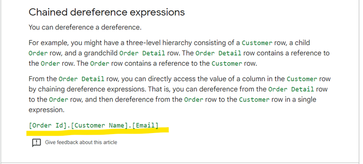

Thanks. I am trying but it is not working yet. Are you sure of that [ID_BUCKET].[ID_ORDER].[Combination] part? is ir right to have 3 fields linked with periods?
as per the images shared by you, "Orders" table is child of Formulas table, "Buckets" table is  child of "Orders' table and "Detail_Buckets" table is child of "Buckets" table. In this case  [ID_BUCKET].[ID_ORDER].[Combination] is called as chained dereference. Please refer the article below
Dereference expressions - AppSheet Help

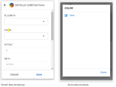

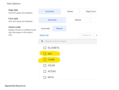

i am not sure that that is the only complication. Here I created a new "pedido" (order), then a new Cubeta (bucket) then open a new Detalle (detail). The Ids are on, but the Combi fields is nowhere to be seen and the colors are gone for good. ๐Ÿ˜ž ๐Ÿ˜ž
CorneliusH_0-1717196393151.pngCorneliusH_1-1717196417568.pngCorneliusH_2-1717196437606.pngCorneliusH_3-1717195782066.png
You may want to check /share what is the expression fir the [color] column and what it shows in the test pane.
Also earlier the [Color] column was in " Detail_Buckets" form. Here I see only " Buckets" form.
