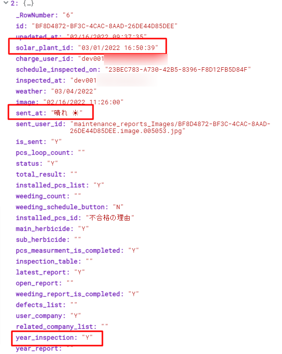

 Data could be acquired, but the data to be obtained was partially different.
Key is correct. However, the corresponding value is incorrect. It seems to refer to the value of the table before slicing.
Please fix if it is a bug.

"Key is correct. However, the corresponding value is incorrect. It seems to refer to the value of the table before slicing."
Which value is incorrect? Slices don't change any values, so not sure what you're referring to. What exactly is the issue?

Let's take an example of the value of json.
The part of the red frame does not clearly match the Key.
The [solar_palnat_id] at the top is text, but the datetime are displayed.
I compared json with the original spreadsheet data source.
Then the data seemed to match.
Therefore, it is possible that the data in the original data table was extracted instead of the data in the column specified in the slice.
Thanks.
Yes, I see the inconsistencies between the 2 screenshots. Maybe you need to regenerate your Table?
Although this:
"I compared json with the original spreadsheet data source.
Therefore, it is possible that the data in the original data table was extracted instead of the data in the column specified in the slice."
...still doesn't make sense. The json data matches the original data source? What is the second screenshot of though, is that not the original data source?
The second screenshot is the original data table.
[new_slice] sliced this table.
[new_slice] uses "Custom" of "Slice Columns" to delete some columns.
Of the [new_slice] json data called by the API, the key is correct, but the value matches the value in the original data table.
I want the API to extract the values of the columns selected in the slice.
Sorry for my poor English ...
