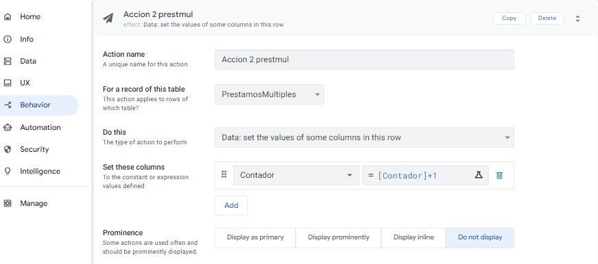

The value of the counter column increases in the row of the "multiple loans" table. The addition of the other rows to the table did not work.

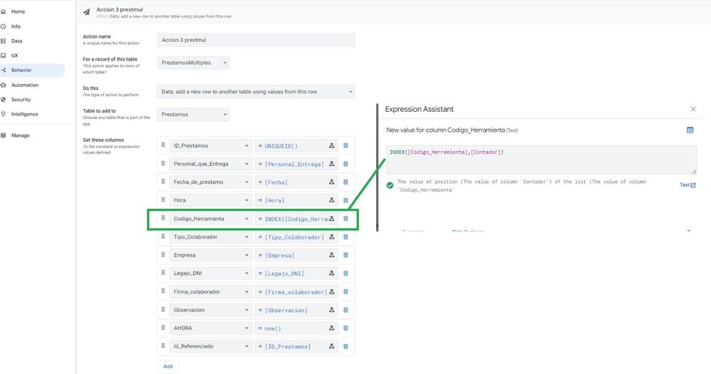

When activating action 3 manually, it tells me invalid tool code, it is because it is reading the first code from the enumlist that was already sent to the "loans" table, the only record that it sends, the first... if I delete this record in the table "loans", it lets me activate and send the following tool, if I activate the action again without deleting the previous record, the error message invalid tool code returns... the problem is that for some reason this expression:
I don't know why. When sending the data to the table loans, it assumes that the enumlist is a single value and not a set of values. In google sheet it works, I don't understand why not here, it has to be something with the configuration of the Codigo_Herramienta column in the MYSQL database.

What happens if you change the index number as a real number, like set it as "2"?
I can't change the value of index to an integer in the expression, it tells me that it is invalid. It only works if I reference the column [ToolCode[ which is enumlist.
What I mean.. INDEX([Codigo_Herramienta],2)
nothing changes, it just creates a single row in the loans table with the code of the second tool in the list

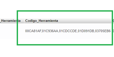

If you check the EnumList column and its value in the database, what it looks like?
data is saved well

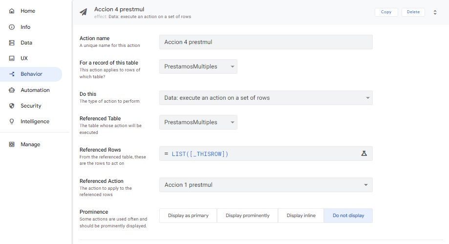

To me it sound like maybe your loop isn't proceeding after the first iteration. Does the [contador] value ever end up being more than 1? What behavior condition do you have on your loop repeater action (#4)?
I don't understand what you mean by behavior condition of action four, I don't have any if valif, just the configuration:

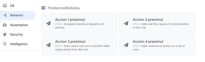

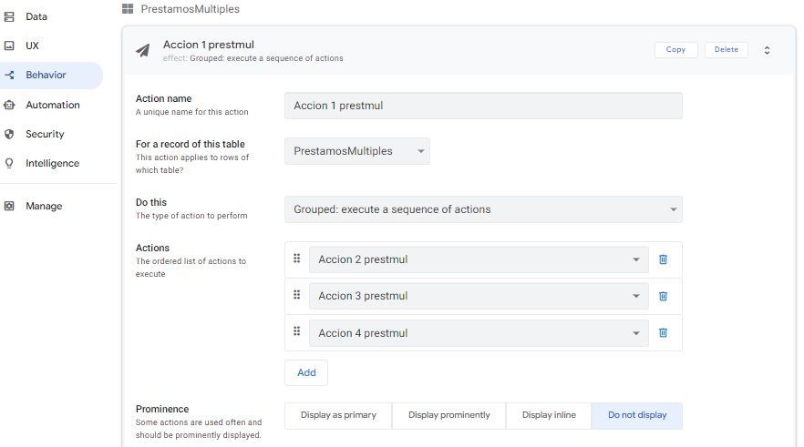

Here are the actions:action1.jpgaction2.jpgaction3.jpgaction4.jpgactions.jpg
Behavior condition:
On action loops, you need a behavior condition on your loop repeater in order to stop the loop when appropriate. Otherwise you get an infinite loop. Yours should be something like [contador] <= COUNT( [enumlist] )
