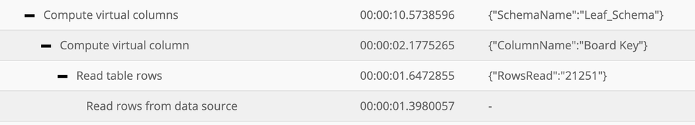

If you haven’t checked out Performance Profile, do check it out to pinpoint any slow processes and Virtual Columns that may make your sync speeds very slow. If I had known how to use this earlier, I would have been in much less of a world of hurt. Find it via: Manage → Monitor → Performance Profile. You’ll see a table that has a Binoculars icon. Click on it and you can march down on what particularly is slowing you down.
I have a fairly complex app (it basically contains 2 years worth of medical school with all the connections and associations students need to learn to be good future doctors…). The database is Google Sheets, so when I run the Performance Profile, I get the following results for one of the tables:
1.901 seconds to read 44274 rows
1.263 seconds to update 1 row (as in Edit actions)
My question is, if I migrate to an SQL, how much of a speed improvement can I expect? Will it be half the time, quarter of the time, etc.

Table reads, according to the performance analysis, seems to make up much of the time required to compute a Virtual Column, which for me contains a SELECT expression. I was hoping the SQL would reduce these times significantly.

@Sean_Lim Hi Sean, less than 2 seconds to read more than 44,000 rows in Google sheets is actually not bad. If you migrate to a SQL database, there might be some small performance improvement, but you’ll need to take into consideration the additional cost of using SQL.
Based on your description of the problem, I believe the real bottleneck is the time taken to compute virtual columns. You mentioned using the SELECT expression, which can take a very long time to compute. To understand why, consider this scenario.
Suppose you have a table A with 44,000 rows, and this table has a virtual column with a SELECT expression. In the selection condition of the expression, you compare a column in table A to a column in table B. Suppose table B has 21,000 rows (I’m just basing these numbers off the screenshots you shared). Because you need to compare every value in table A against every value in table B, this would result in a total of 44,000 x 21,000 comparisons. If every comparison takes 1 microsecond to be performed, that would result in a total computation time of 924 seconds, or 15.4 minutes.
Of course, the sync time of your app is much smaller than 15 minutes, but you get the idea. Based on this, the biggest improvement in your app’s performance would come from either simplifying your virtual columns, or from reducing the number of rows that are used in these virtual columns. If possible, avoid using expensive expressions like SELECT or LOOKUP with large tables. It’s also a good idea to archive old data that is no longer used. You can do this either by removing old data from your spreadsheets directly, or you can filter data using security filters in AppSheet. For Google sheets, security filters will not reduce the amount of data that our server has to read from the sheets, but they do reduce the amount of data that will be used to compute virtual columns, so they can be a big help. If you use SQL databases, security filters will also reduce the amount of data that our server reads directly from your SQL tables.
