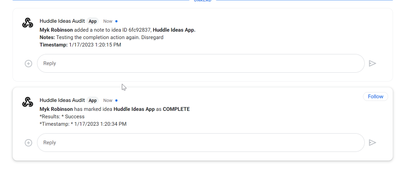

had to do some homework to learn about the Input() function, but that worked well. I removed the results option from the note and instead pushed the Input() function to allow the user to input the results upon record save, as you noted, and it worked fine. It also pushed the data to the app audit chat. I have some JSON formatting to fix, but otherwise, it's alive.
thank you!
