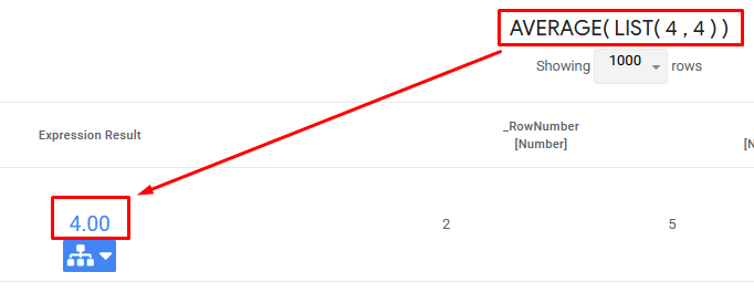

Average issue (super simple for pros i think)
Issue is “Average” doesnt work for numbers
for example average for:
4
4
gives average 2, but it should be 4…
0 6 304
Seems to work fine here. You’ll have to further describe your issue if you’re seeing different.
For reference:
Still issue:
I think its counting empty cells as 0.
Hove i can skip / not take empty cells to average output? I mean if i have for exmpl 3 rows
2
Empty cell
3
Id like to have result 2,5 without 0 on row 2…
Please post a screenshot of the complete expression you’re using.
So its just simple chart, no expressions yet.
Problem is when i add those 4 and 3 numbers i should get 3,5 average, but now its counting empty cels as zero, i think, so average its lover and lover every time empty celss appear. Because students dont haveto add numbers every time…so i think it should have something like “countifnotblank” like expressioins…
I suggest making a Slice for only those records with values, then basing the Chart View on that Slice.
